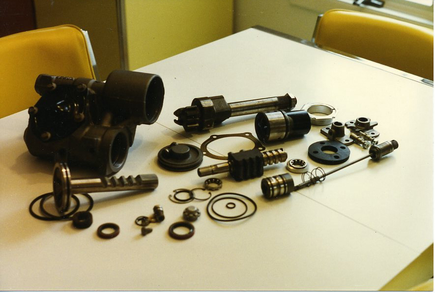

Lets look at the exploded view of all the parts. Thank you Sam for this great picture ....
Don't be alarmed, you can rebuild one sub-assembly at a time.

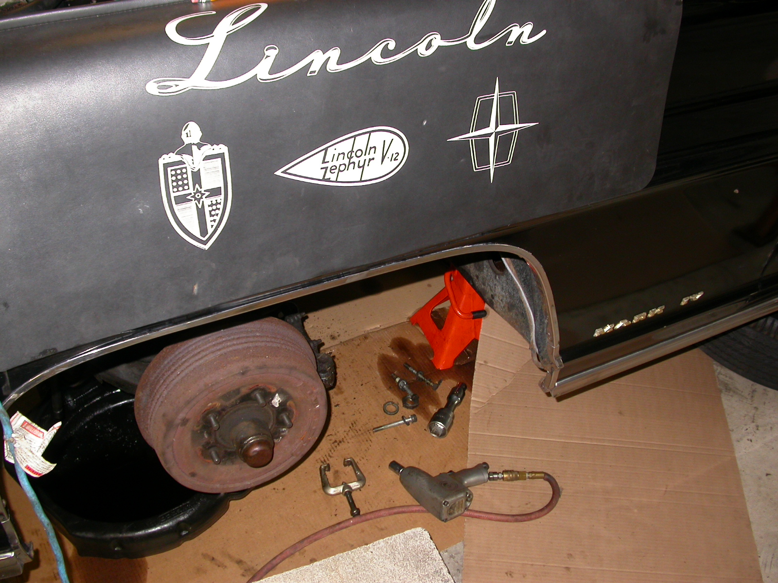

Get your vehicle safely supported. Wear safety glasses.

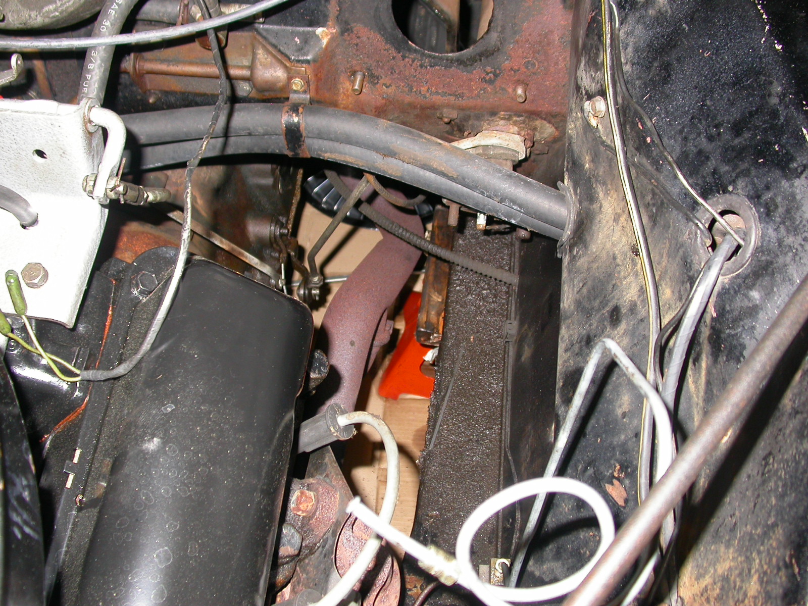

First you want to disconnect the steering linkage from the Pitman arm. Using the steering arm puller remove the Pitman arm.
Remove the three bolts holding the unit to the chassis.
Opps ....You might want to disconnect the rag joint first. Inspect the rag joint carefully and replace it if necessary.
I also removed the brake booster for accessibility.

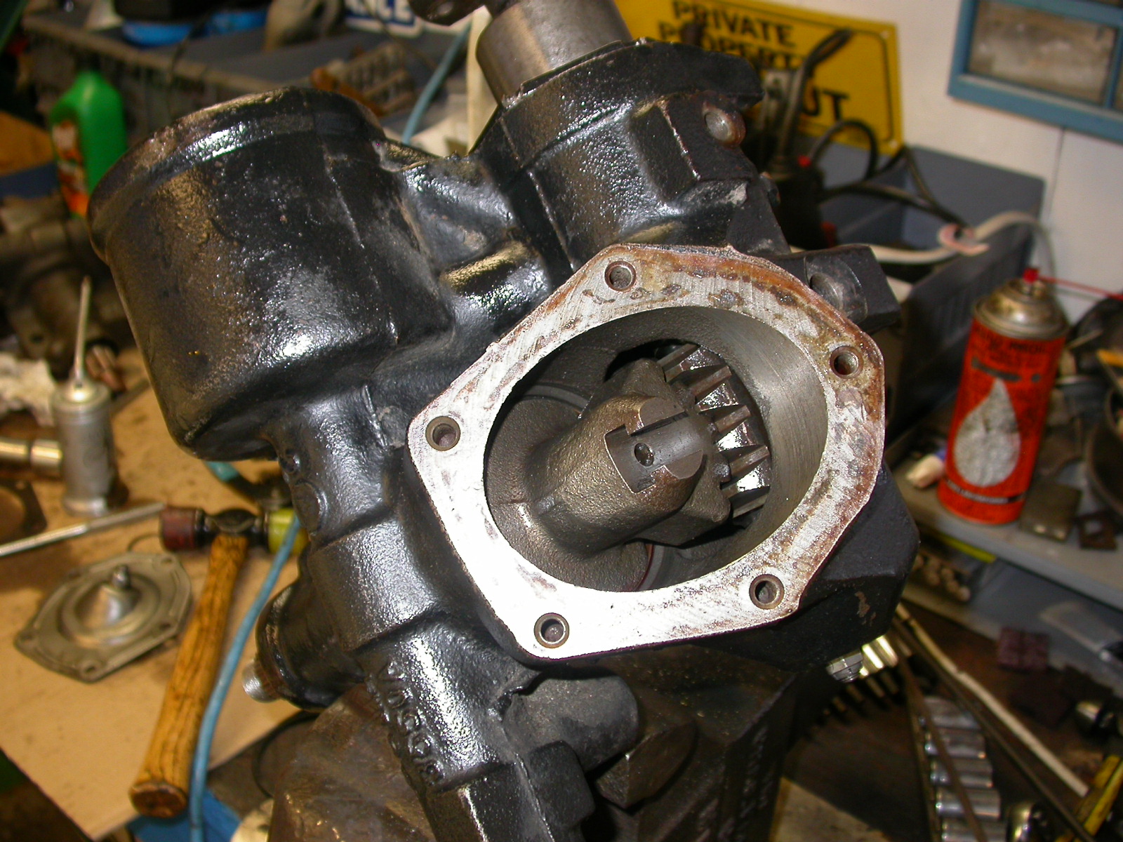

Set the unit on the bench or vise and remove the 5 bolts and remove the adjustment cover. Do not change the adjustment on the adjustment screw. Just leave it alone. If your leaking fluid from there. go ahead and replace the seal ...I believe its a copper ring...maintain the correct adjustment.

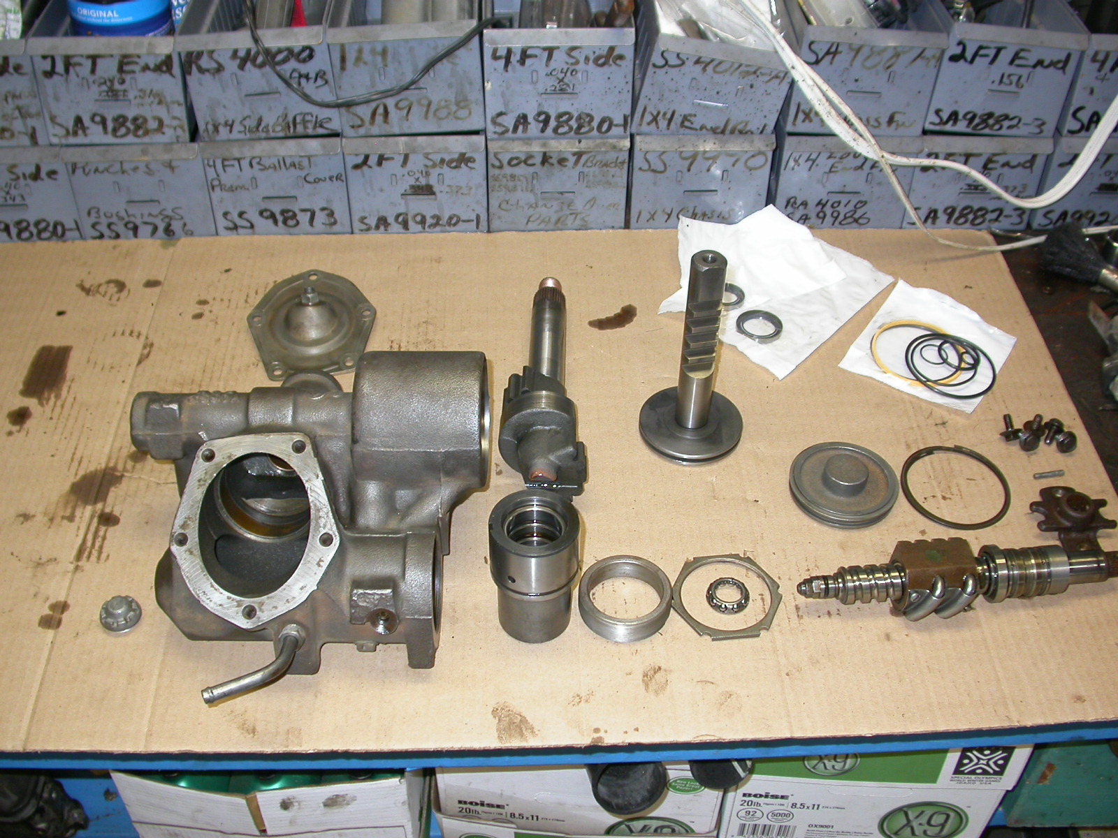

Here are the sub assemblies. Im also showing extra parts so you can see how everything goes together.

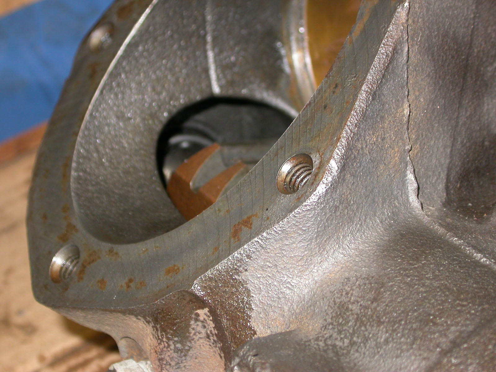

Carefully inspect the casting for cracks or stripped threads....this one looks good...

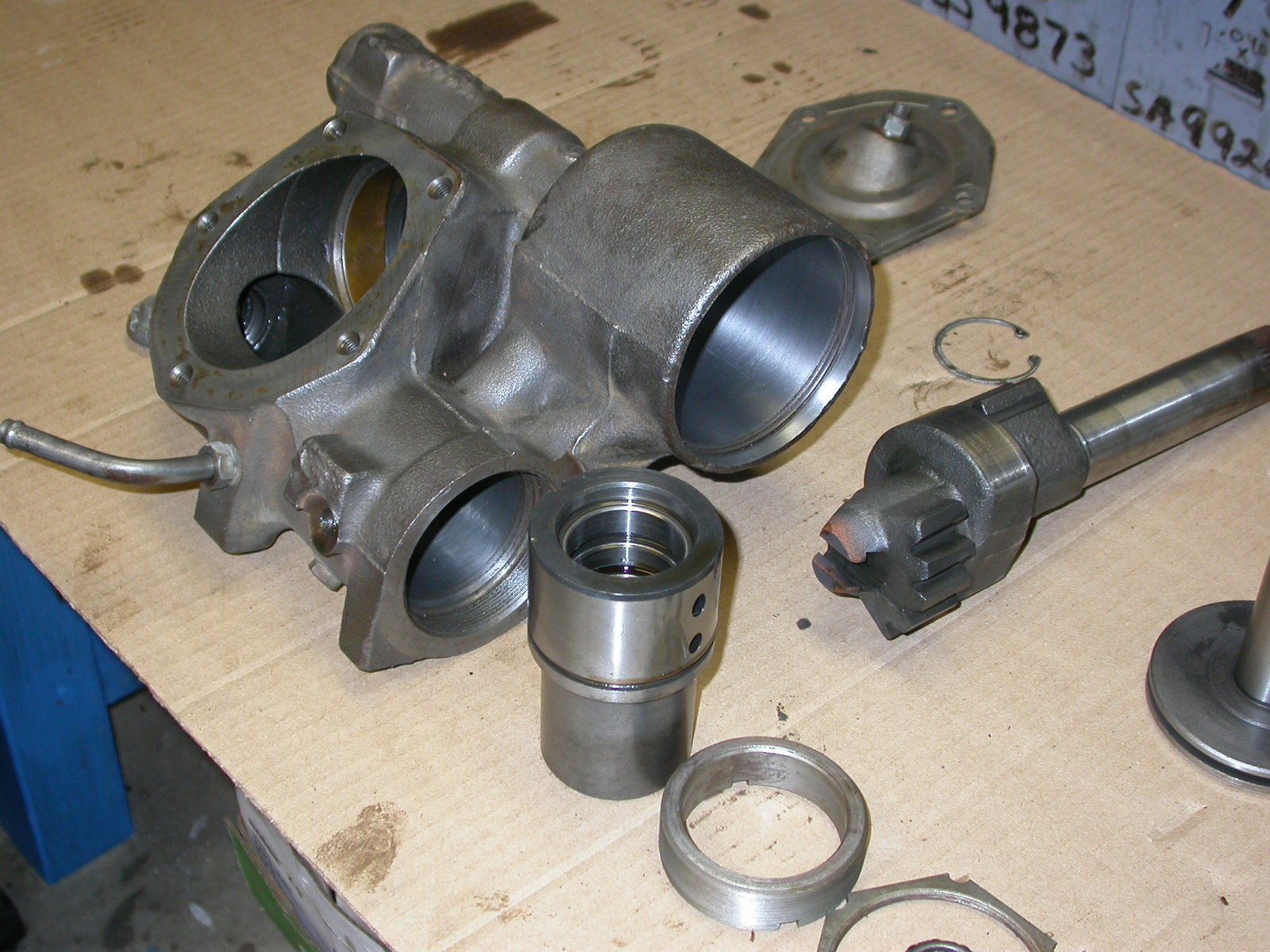

Here is the unit broken down ....
Take each part clean it, replace all the seals. I would caution you if you decide to take apart the piece with the ball bearings in it. I'm just sayin....
Look at the piston at the far right ...the red paint is highlighting a crack in the piston! Naturally I discovered this problem after I re-installed the unit and had the same problem. I can whip this steering box in and out in record time...! So don't let this happen to you.

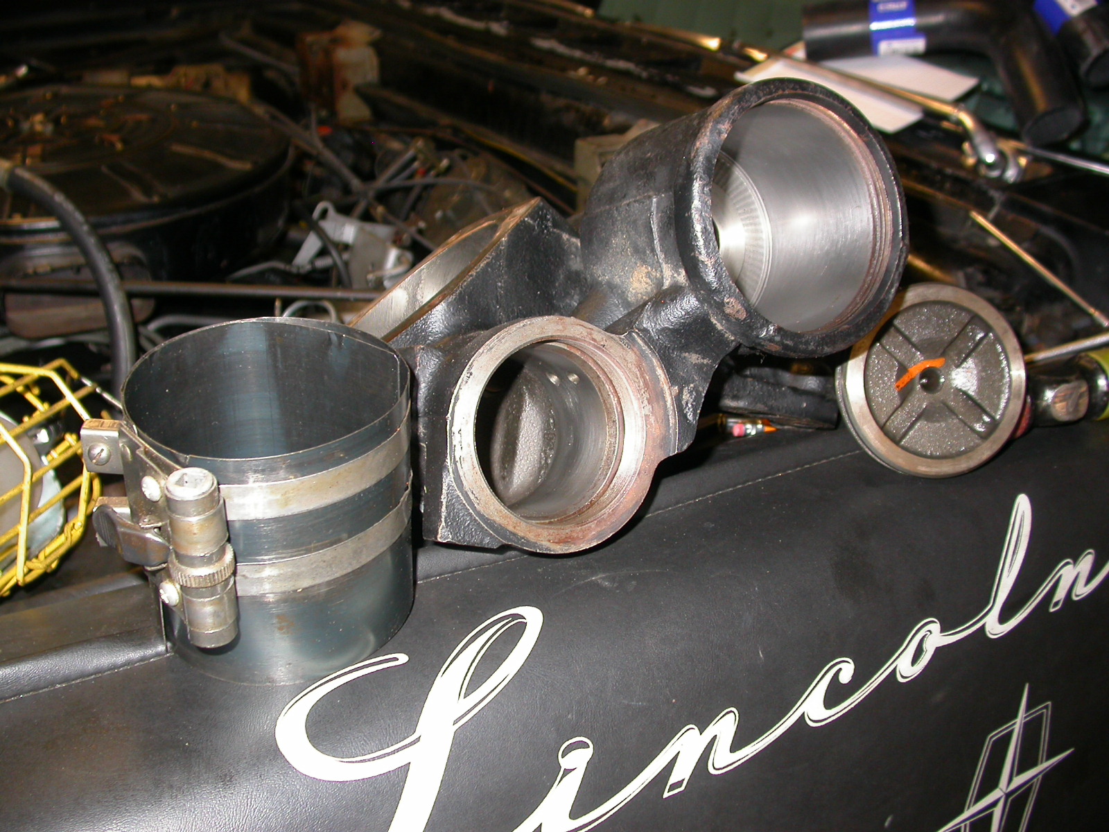

I carefully honed the cylinder before I assembled the unit.

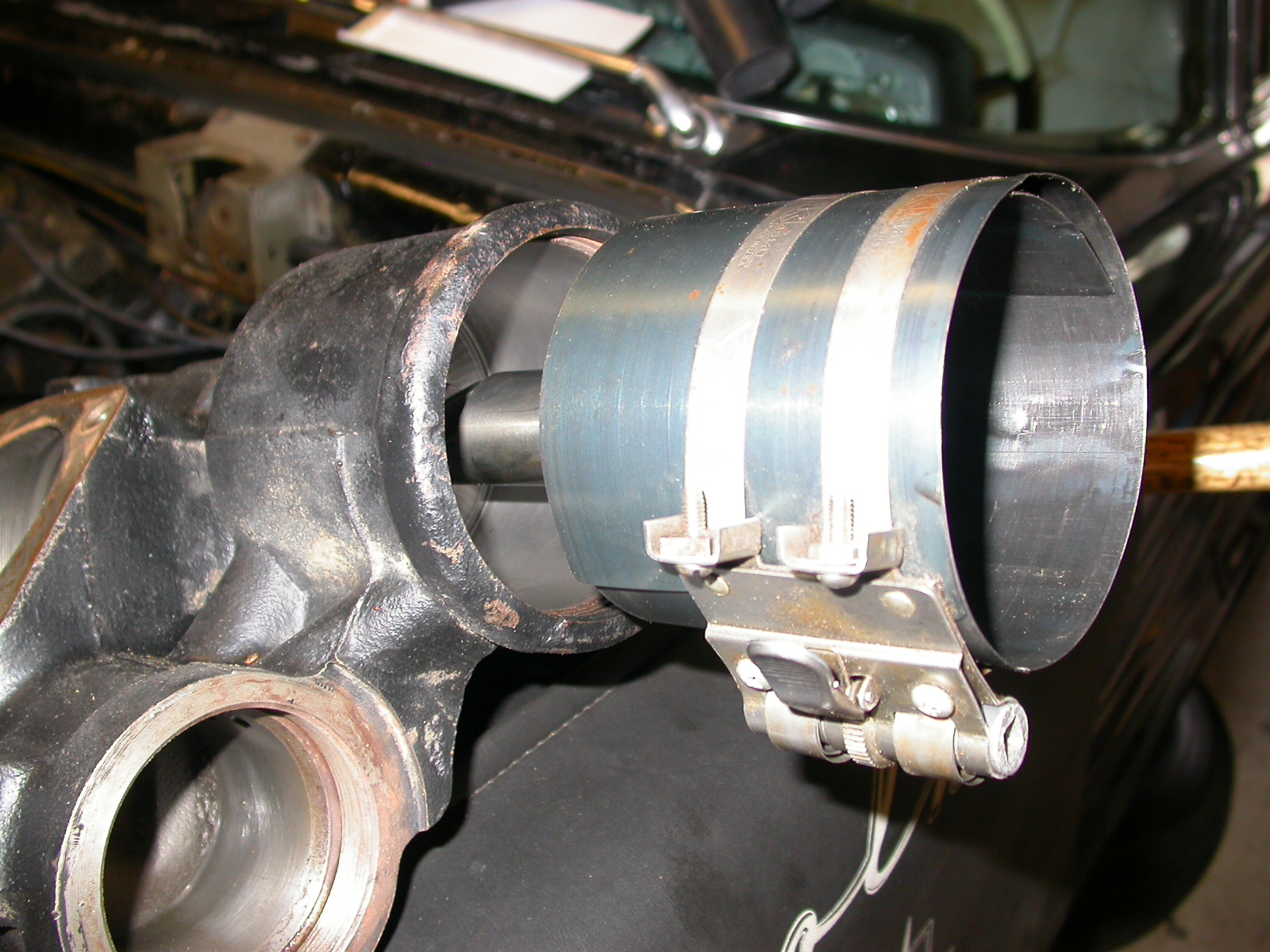

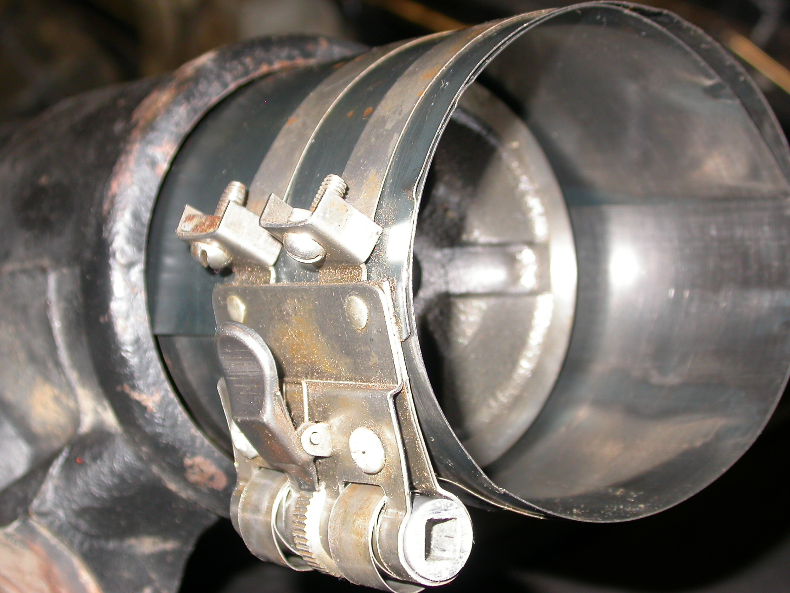

Using the piston ring compressor tool slowly insert the piston into the bore tap down lightly with your hammer handle. Be sure to wipe some oil in the cylinder.
