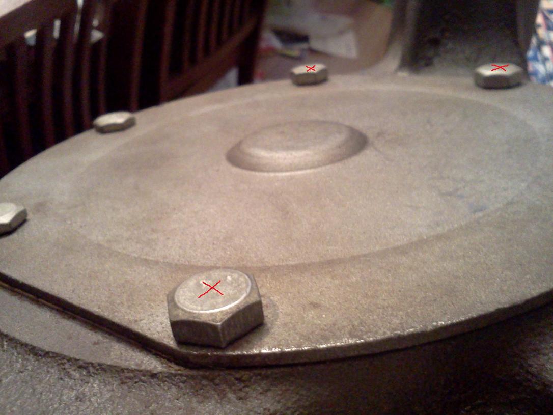

A rebuild pump I recently purchased. Note the replacement bolts with red X vs. the original bolts.
