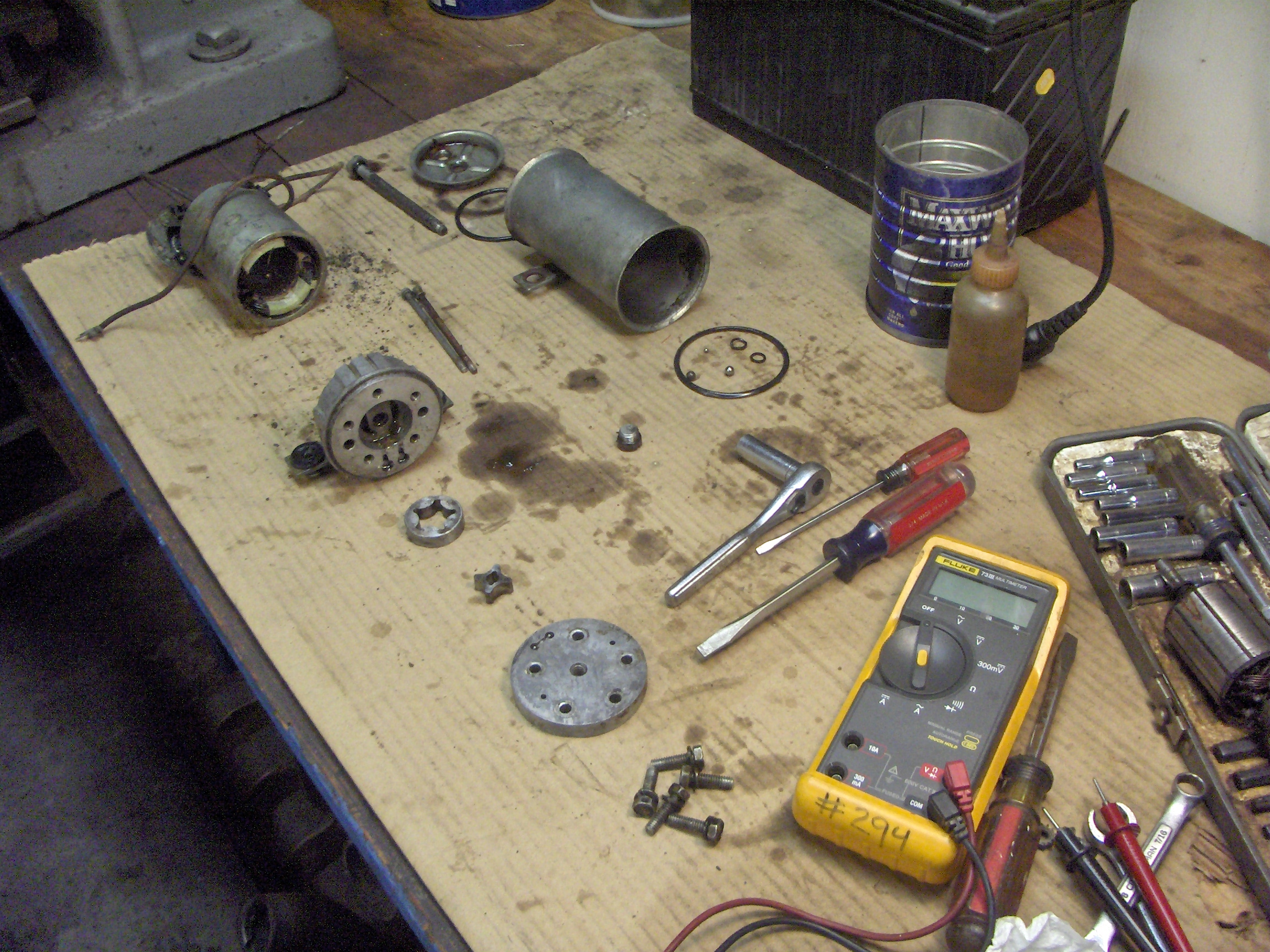

Carefully disassemble the pump remove the 3 sided bolt with slip joint pliers.
Remove the smaller 5 bolts to separate the pump housing.
Be careful . there are 2 small check balls and one smaller ball that locks the impeller to the motor shaft...
Lay everything out and clean with rubbing alcohol and a brush. Electrical cleaner works well too.
Be sure to clean and blow out the motor winding. The brush plate will need to be cleaned as well. Make sure the brushes operate smoothly back and fourth in the cavity.
Lets resurface the pump components. Using a flat surface a sheet of 400 wet / dry paper and some light oil.
Carefully oil finish the mating surfaces. When you are happy with the results clean the parts and dry.
Be sure not to loose the thrust washers on each side of the armature.

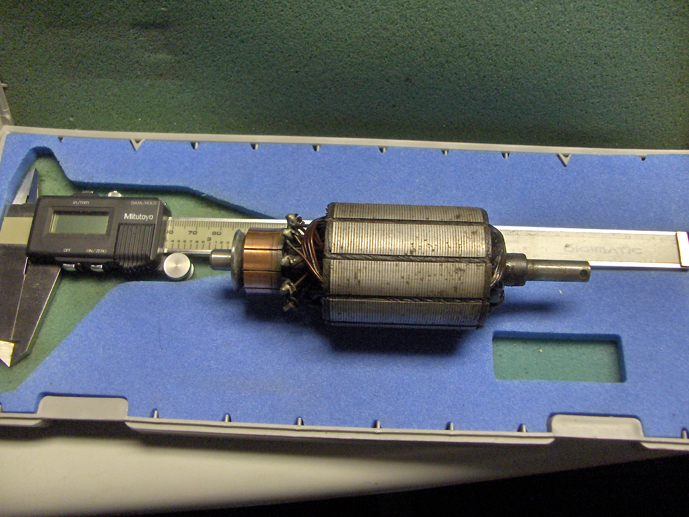

You want to clean the armature with some scotch bright.
