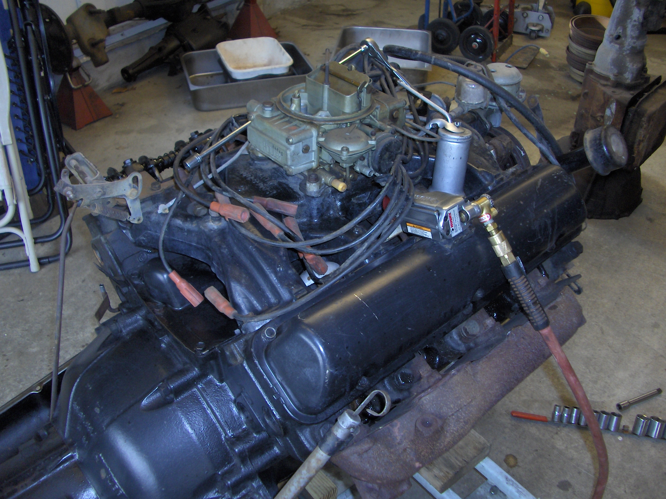

Another trick I use is to pressurize the system using a brake power bleeder. Fill the jar with motor oil Install a fitting at the oil pressure sending port and pump it up to 25 lbs. about 2 quarts. This will Pre lube the system.

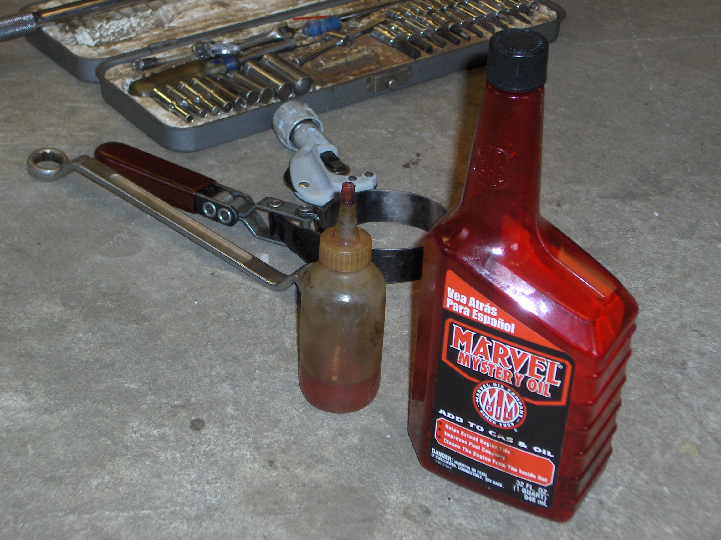

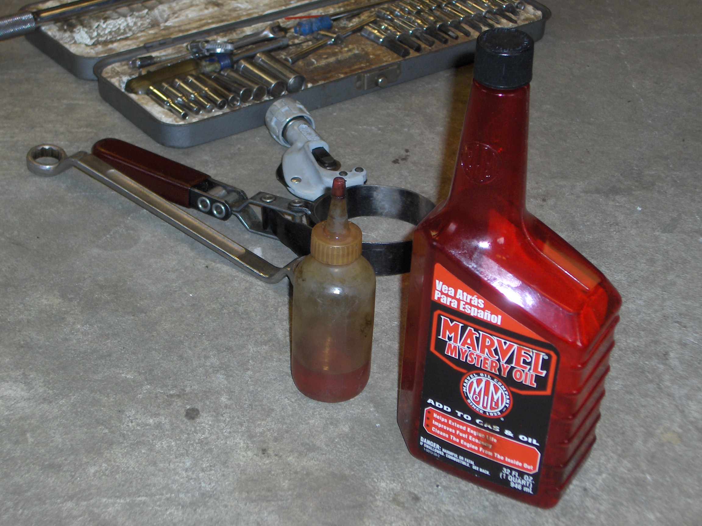

Squirt some Transmission oil or Marvel Mystery Oil into the cylinders. A few tablespoons per cylinder should do it. Turn the engine over by the crankshaft bolt using a breaker bar. If its free you can go ahead and carefully crank it with the starter. If it don't move, let it soak for a few days and try again. This may take several weeks.
Motor oil or Marvel Mystery oil works great

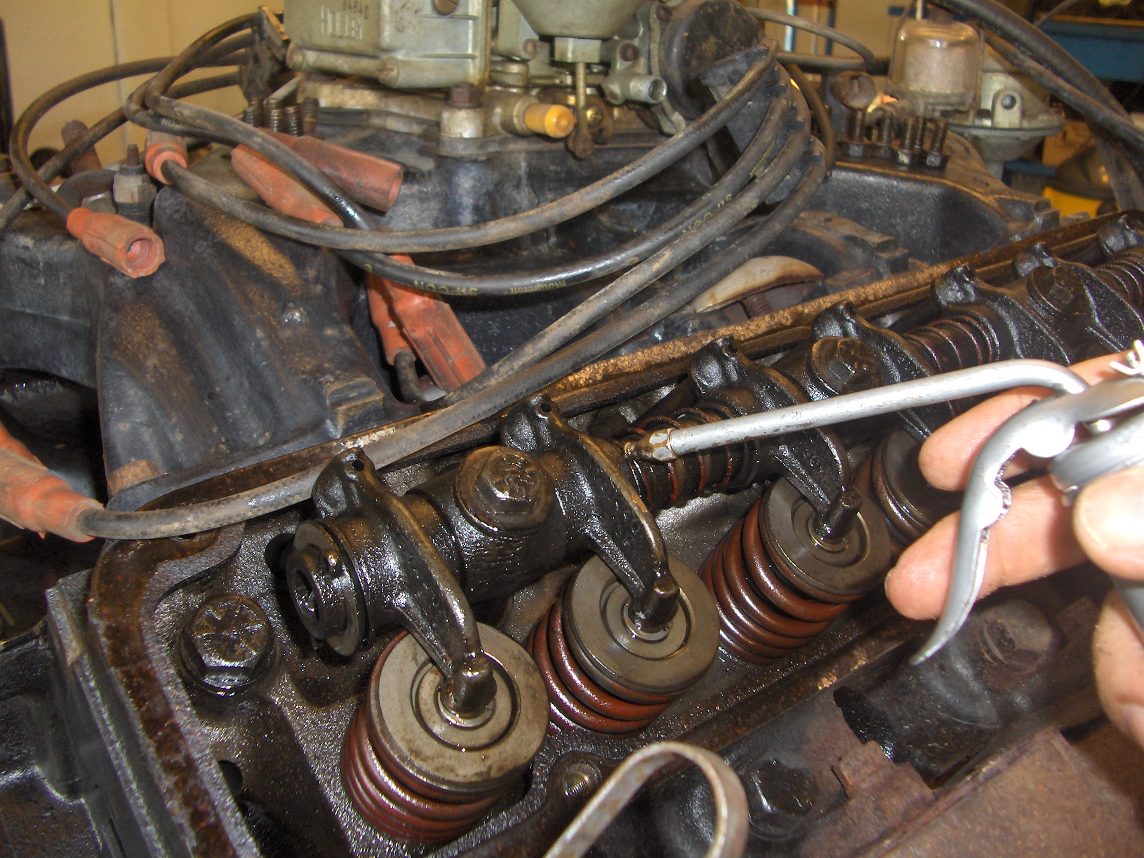

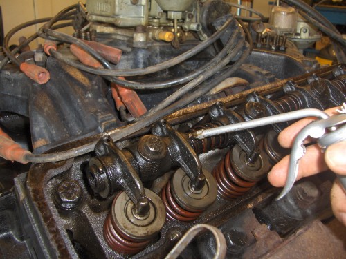

Its a good idea to remove the valve covers at this time and oil up the rockers and valve stems. Pressurizing the system would be my first choice.
Oil the valve train

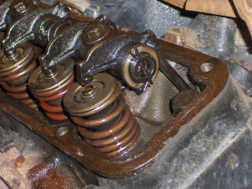

Looks like a stuck valve. Squirt a little oil on the stem and lightly tap it with a plastic hammer back and fourth. After a few minutes it popped back in place.
OK ..... and this valve needs a slight adjustment?

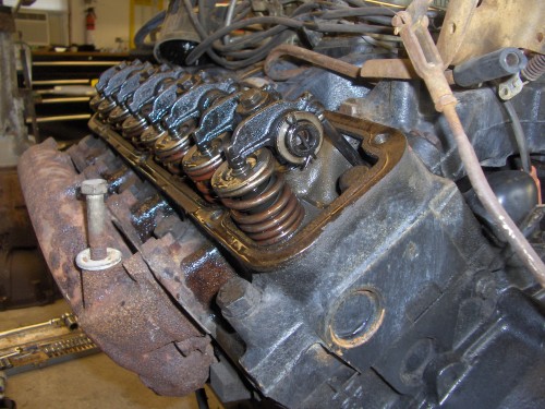

Houston, we have a problem!
OK so it never goes as smooth as you would like......

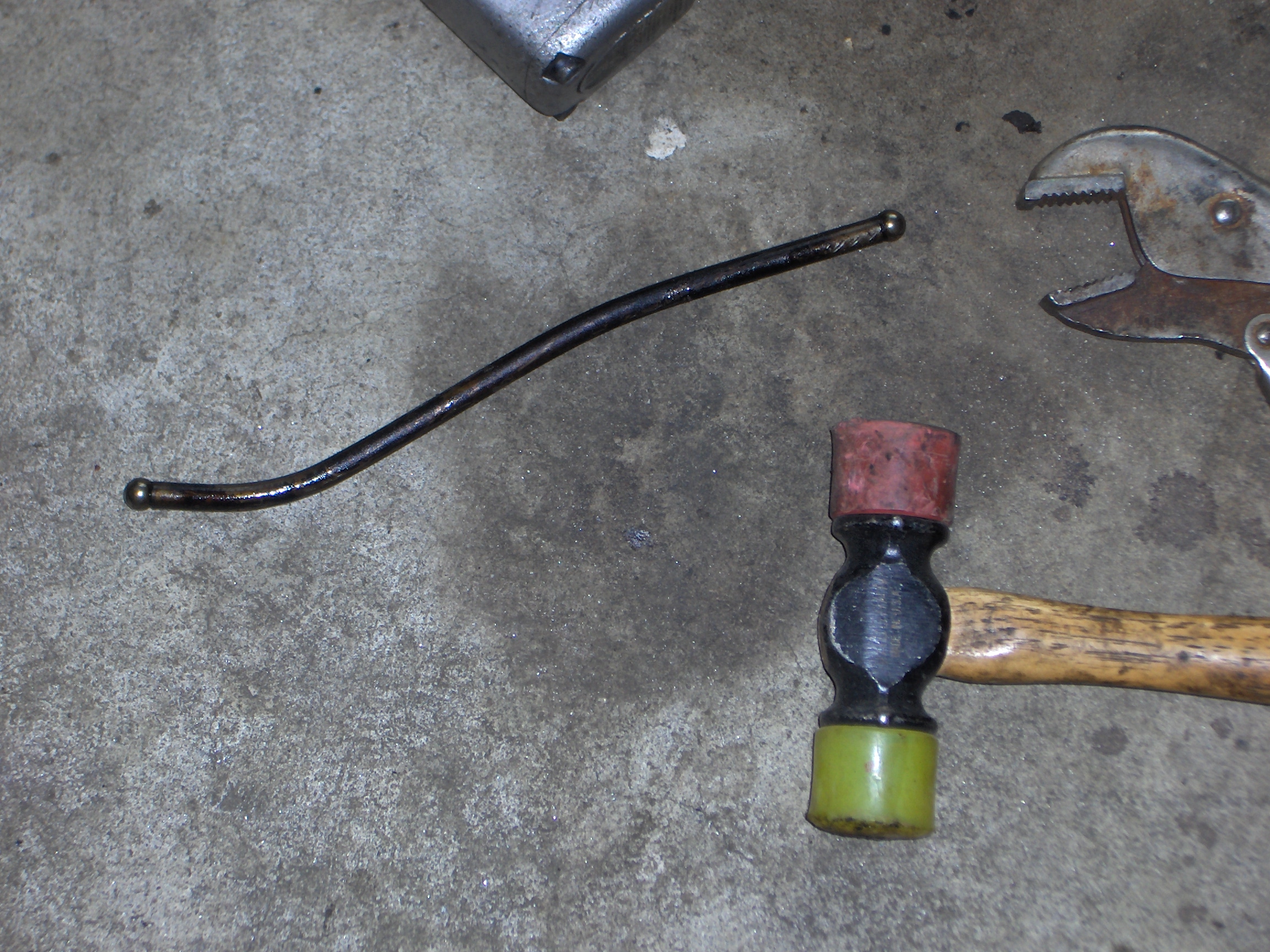

This engine has a few problems from sitting so long.
I replaced the push rod with a straight one
