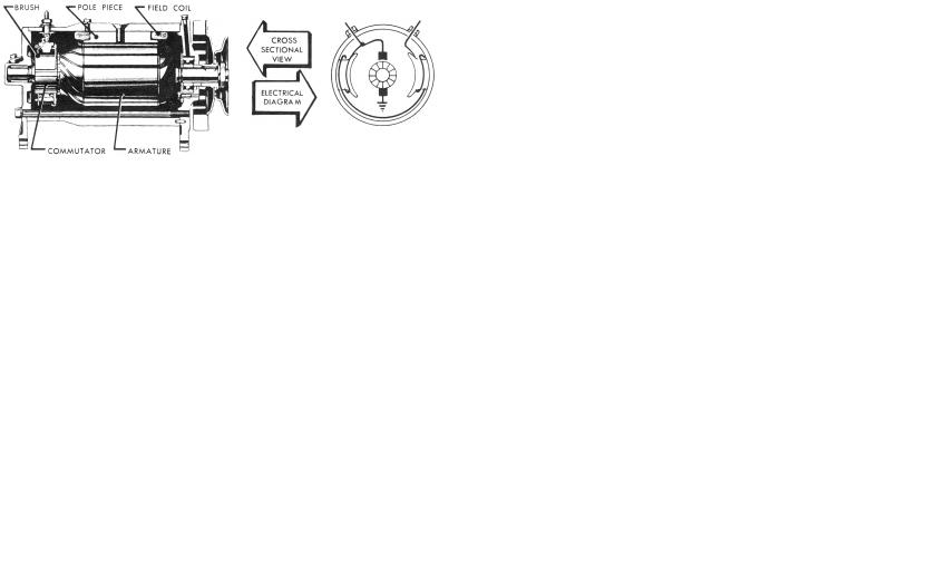

ARMATURE
- An armature starts out as a bare hardened steel shaft. To this shaft is
added a series or group of non-insulated copper wires wound close together. They in turn will form what is called a loop.
The loops of wire are then embedded in a series of slots in an iron core. This iron core is then attached to the armature shaft. This shaft spins and helps to generate the electrical current. As you might guess, the size of the wire and the number of wires in the loop will affect the output of the generator.
COMMUTATOR
- The commutator is a series of segments or bars that are also attached to the armature shaft at the rear of the armature. It is the wire ends from the loops of the armature windings in the iron core that are attached to the commutator.
When this is done, a complete circuit is formed.
FIELD COILS
-Field coils are the windings or the group of wires that are wrapped around the pole magnet. It is the job of the field coils to take the current drawn to the pole magnet, and make it stronger. (Field coils are the windings that are attached to the
inside of the generator housing.) This increased strength in current will force even more current to be drawn to the pole magnets, which will continue to build up current. This is how the current produced by the generator is built up and increased, until it can be used by the battery and the accessories.
The ends of the armature loop are securely attached to a split ring called a commutator.
BRUSHES
- After the generator develops the current, it is the brushes that carry the cur-
rent to the “field” circuit and the “load” circuit, so the electricity can be used by the battery and the accessories. This process is called “commutation.” The brushes will ride on the commutator segments of the armature. Brush holders hold the brushes in position by way of spring tension. Most automotive generators will contain
two brushes, one that is grounded to the frame of the generator, one that will be insulated from the frame. The insulated brush is the positive
brush and is connected to the “A” terminal of the generator, and to one end of the field coils. The other end of the field coil is connected to the insulated “F” terminal of the generator.
BEARINGS AND BUSHINGS
- At either end of a generator you will find a bushing or a bearing. They have the job of making the armature shaft run true in the housing between the field coils and pole shoes. Bushings will be made of copper or brass and are soaked in oil before they are
installed. The brass or copper bushing material is porous and able to absorb the oil like a sponge. This provides the lubrication between the shaft and the bushing. They can also be re-oiled from the oiling tube on the outside of the generator. Some heavy-duty generators will use ball bearings instead of bushings for the armature shaft to ride . This is done to support a radiator fan or other accessory.

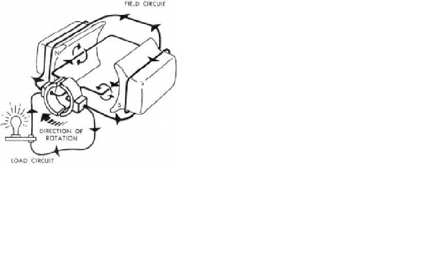

First let’s look at a simple generator with an armature that has only one turn or loop
of wire and two pole pieces. These pole pieces (actually magnets) will always have some
“magnetism” left over from the last job they did.
However, these magnets are week because of the magnetic field between them.
(Remember these two magnets are exactly opposite of each other. That is the cause of the
weak current. They will tend to cancel out each other.)
If we place the armature between these two magnets and then spin it in a clockwise
direction, a weak voltage will be “generated.” Remember, the rule of generators says that
any current generated will flow to the conductor if it is a complete circuit. Because the
armature is a complete circuit, the current will flow to the armature and then to the field
coils where the voltage will be increased.
The rotating armature cutting through the current produced by the field coils forces
even more current through the field coils that makes still more stronger voltage. This is
how the voltage generated by the loops is increased into voltage that can be used by the

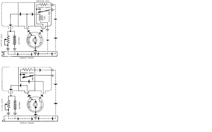

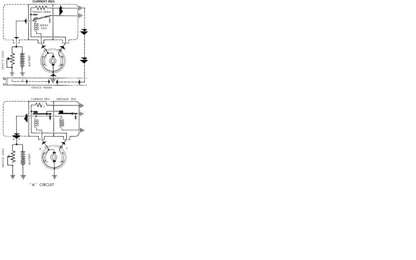

To prevent this damage, a current regulator is necessary. Just as it sounds, a current
regulator limits the amount of current the generator is allowed to produce for both the
electrical demand of the accessories, and the safe limit of current the generator can produce
without damage to the generator itself.

TIME-SAVING TIP: Before we go on, here’s a quick reminder to check the wiring between the regulator and
the generator. While this sounds like no-brainer, you would be surprised how many times the wiring gets
switched by accident. So as a simple review, and in order for everything to work properly, things should be
connected as follow.
1 The positive wire from the generator will be connected from a post on the generator (marked either
“B” for battery or “A” for armature) and should be connected to the (armature) terminal of the regula
tor.
2 The field terminal of the generator should connect to the field terminal of the regulator.

This type of circuit where the regulator
is a part of the field circuit is called an
“A” circuit. An “A” circuit is easily identified
because the contact points are always located
after the field coils. This type of circuit is common
to the General Motors family of vehicles.
The voltage regulator and current regulator are units in the external
circuit used to “sense” either high voltage supplied to the electrical
system or high current supplied to the external loads...see diagram
above.

Check out the following illustrations. A simplified circuit employing both current and voltage regulators
is illustrated. The regulator or contact points are located “after” the field coils (“A” circuit). The
field current is attached to the insulated brush inside the generator.

As seen in the diagrams above, a set of contact points is placed in series with the field coil circuit
and all field coil current passes through them. If these points were to open, current would no
longer pass through the points, but travel through a resistance to ground and then though the
ground conductor back to the ground brush of the generator.
The diagram below show the various factors involved in current regulation and the manner in
which this is done.
