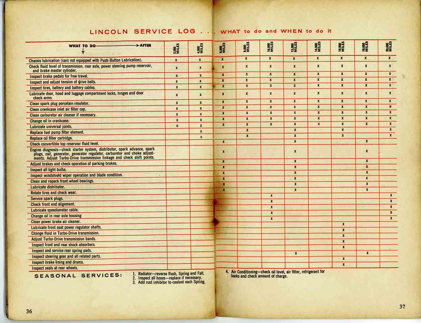

This driver's manual belongs to the rose colored Lincoln pictured in the banner of this site. Unfortunately my scanner's driver is very buggy and creates scans with different settings regardless how I set it up. The booklet is mildly soaked with oil and has probably tarnished the scans a bit.
I post them for educational reasons only. You must not make copies or distribute this material. Just klick the photos for a larger resolution view.
