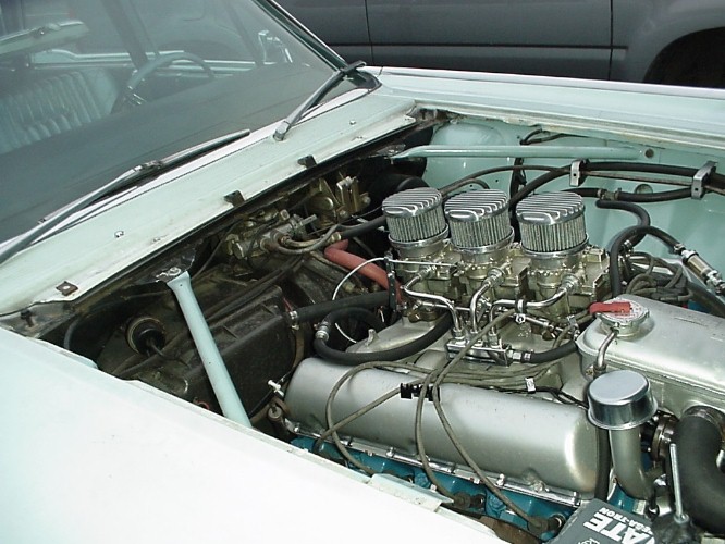

Something Along This Line?

WOW!! Will bolting up this intake to an otherwise stock '63 mel yeild significant performance?
Re: Still trying to figure out how to boost my horsepower?
Yes It Will.....but It will not allow the hood to shut on a slab-side. This guy had to add a scoop, although it is not gaudy (in my opinion). There is very little space under the hood on the 61/ LINC. They actually lowered the carb pad from the 58/60 LINC. So it would be difficult to retro-fit an earlier 4V manifold also.
