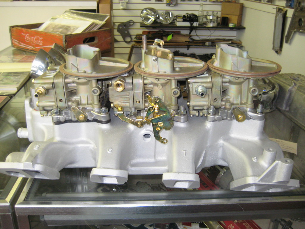

Note that the center carburetor in not an original unit .......the fitting is placed wrong....the center carb has a float adjustment screw at the top causing the front carb not to sit flush ........no provision for the linkage....so is is a deal???

Easy fix...change the bowls to Autolite 2100 like the originals!..or just change that center one only to match the other 2. Mine were 3 indiviual 2barrels but the bowls are now 2100s. Hope that helps but I am no carb guy so correct me if I am wrong!59lincolnrag wrote:Gentlemen:
.... Oh yes ..Joe is the man for tri-power......
And you must make a progressive linkage from scratch

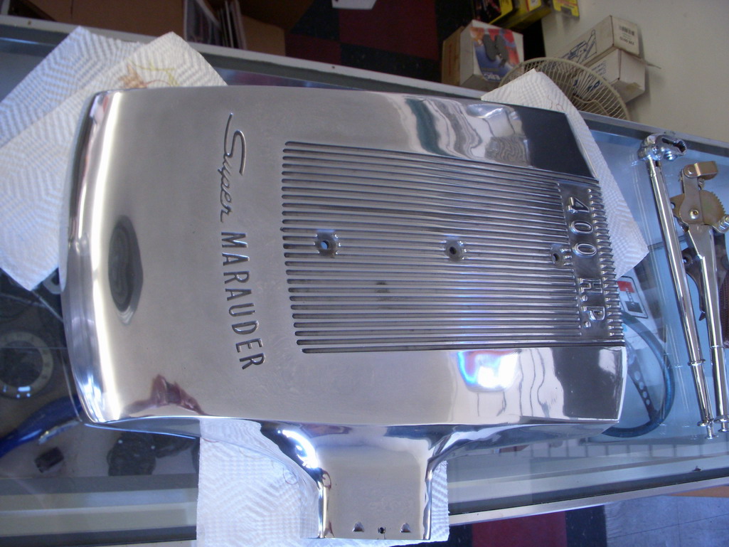

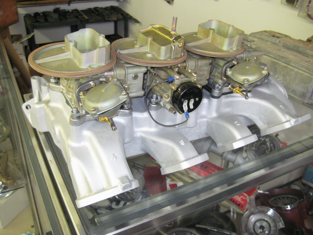

New photos. It has been a long time coming but the rebuild is coming to a close. It still needs linkage, polished stainless steel lines and a fuel pressure gauge. Can wait to see if it fits. If not any takers?
