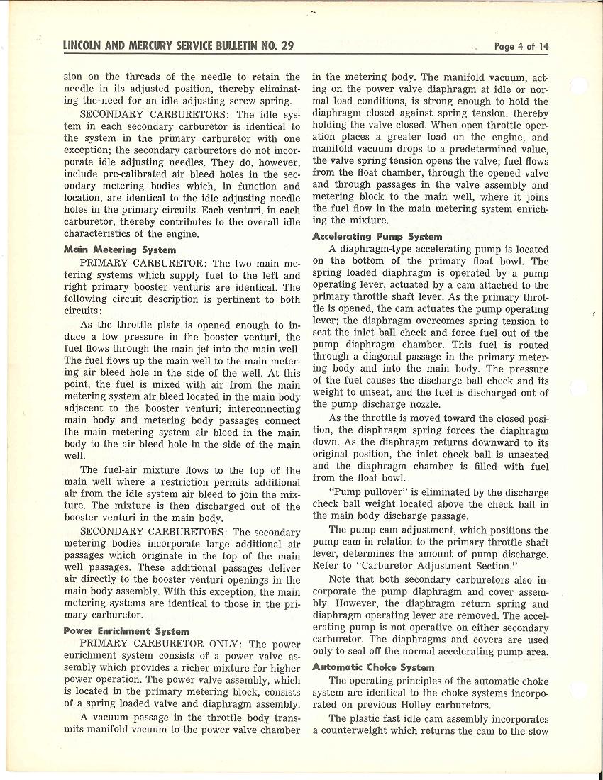

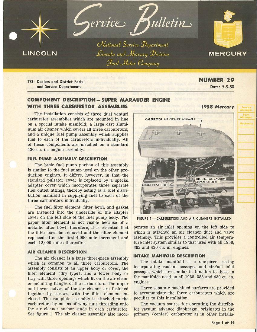

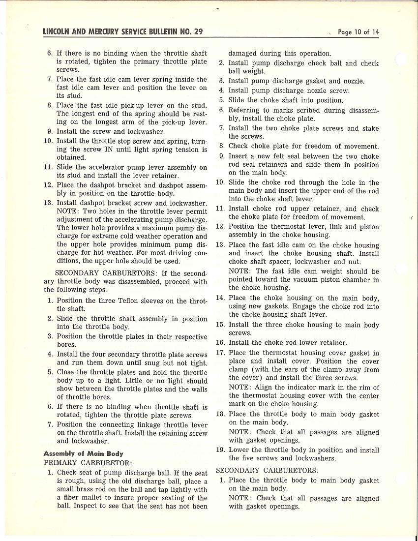

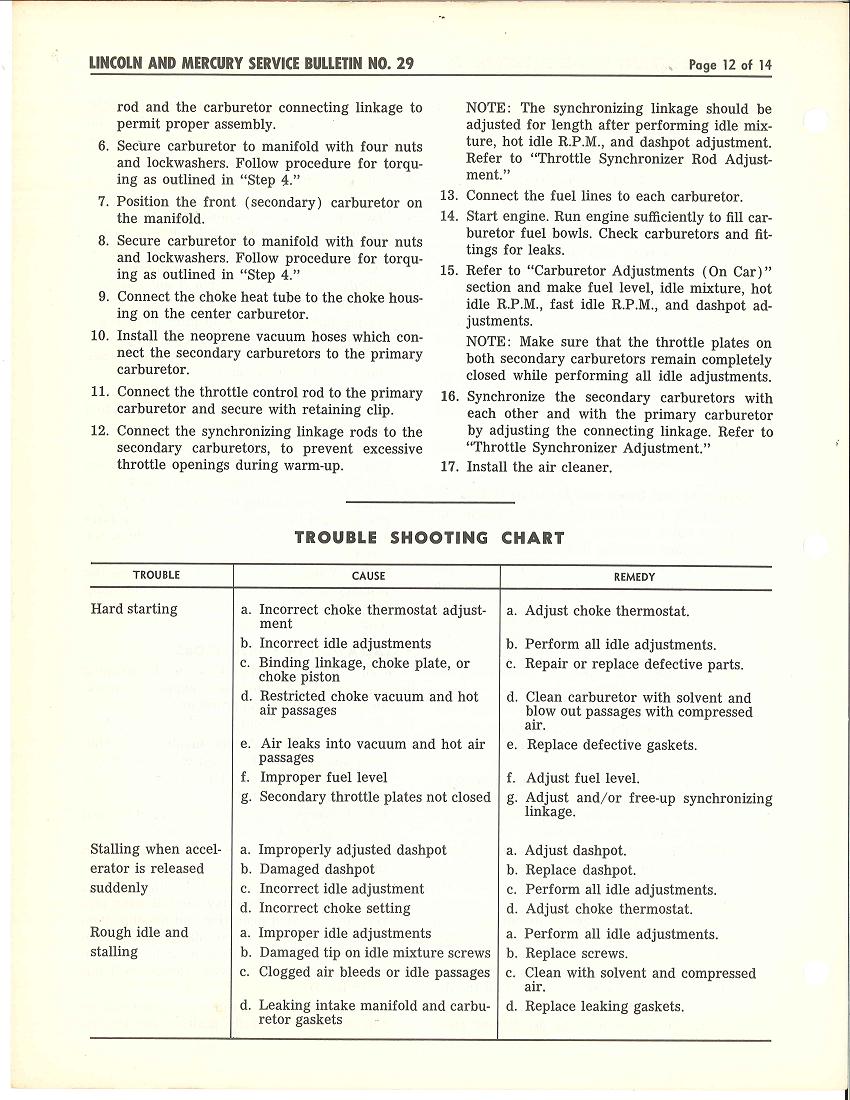

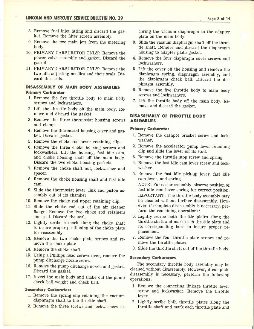

This might help and should give you some ideas by comparison to what Ford had developed. As people have explained to me, the secondaries are held closed by a spring in the diaphragms mounted on the carb bodies. When vacuum is strong enough to overcome those, they begin to open which is supposed to be around 40 mph and also at wide open throttle. There are also vacuum balance tubes connecting all the carbs. People with first-hand experience at WOT have described this setup as all hell breaking loose and fearing it would break loose the rear end ('58 Lincoln) so you probably wouldn't want to engage it all the time and why a vacuum setup might be favored.
Re: Edelbrock L300
Adding some additional content from the 1959 Service Bulletin that was brought to my attention by Joe Paulus. Thank you!
