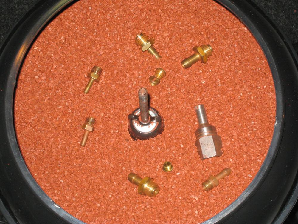

Original brake booster valve and brass fittings.
A vibratory tumbler was used to clean & polish many small parts. Works very well for aluminum, brass and copper parts.

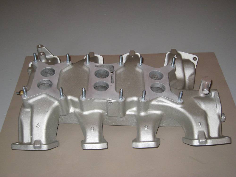

Side view of intake manifold after being soaked & cleaned with a special aluminum cleaner.
Rear view of intake manifold after being soaked & cleaned with a special aluminum cleaner.
Side view of intake manifold after cleaning and painting. Coolant elbow tube installed after replating.
Rear view of intake manifold. NOS temperature sending unit installed. New carburetor mounting studs installed

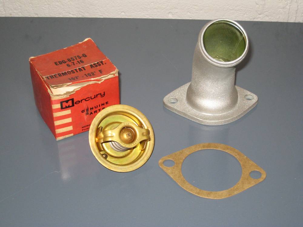

A NOS Mercury thermostat & gasket was installed with a new thermostat housing

Look's new. What media did you use in your tumbler?
