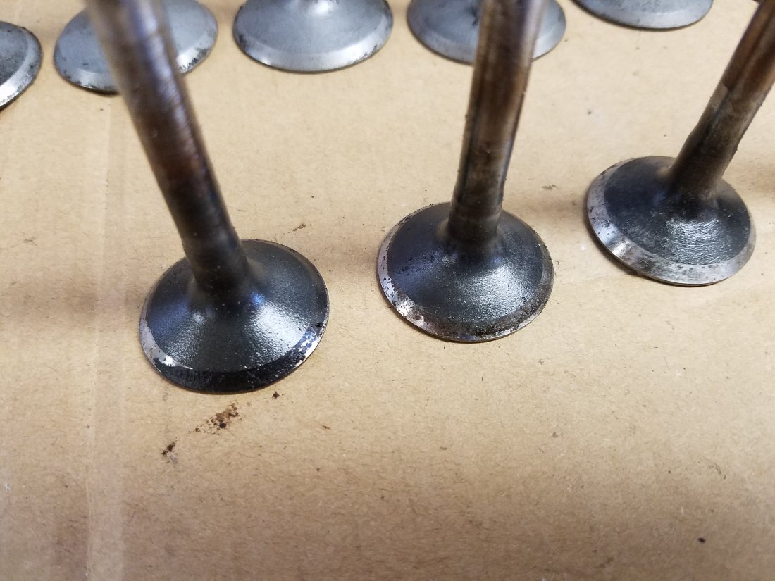

Burnt valves running low octane fuel in high performance engine. 5.4 DOHC 32 valve.

You definitely ran contaminated fuel for a while. You can curve that by using stations that see a lot of traffic. Those stations tanks are circulated often enough for the fuel not to separate keeping water, Ethanol and contaminants suspended. Premium is refined better but some places around my area still have traces of Ethanol and water in their premium. That is according to a local machinist whom uses testing kit for his dyno gas. If you have a custom tuner on that car slighty fattening up the AFR will cool the combustion chamber some and probably slow down the damage done with this junk fuel we're getting these days.

Actually the burnt valves (root cause) were caused by an intake vacuum leak causing a lean mixture on the drivers side. The Intake valves were coated with bits of carbon after using Sea Foam. Low octane fuel only exacerbated the condition.
