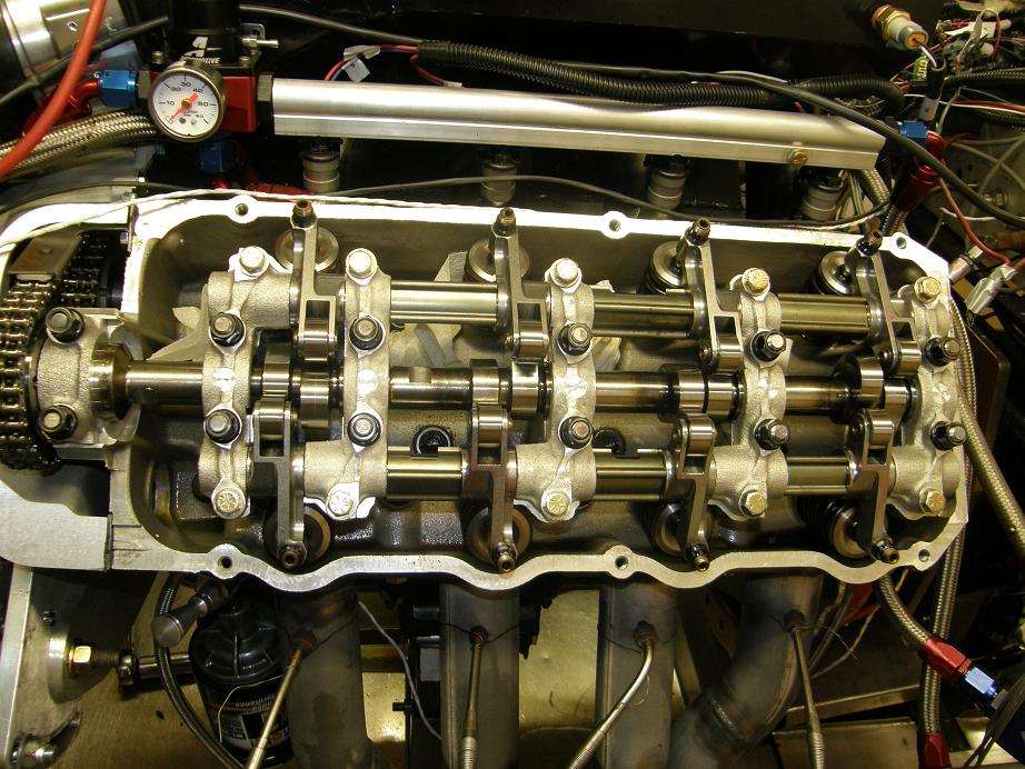

Today I got the T&D rockers installed on my SOHC. Here's a photo of the rockers on the engine:

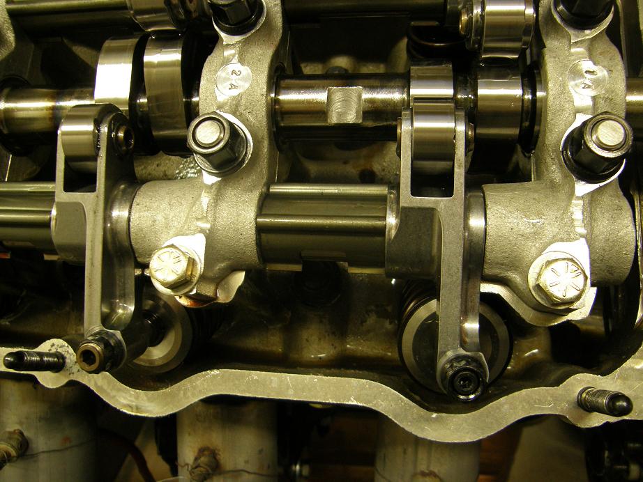

Installation went without any problems, but lashing the valves did not. I started with #1 and went in order through the firing order. However, as I was lashing #6, I heard a "POP - tink tink tink" from the other side of the engine. I went back to the right side of the engine to check, and this is what I saw:
Yep, a broken adjuster. This reminded me of all the broken adjusters I had to suffer with my RAS SOHC rockers. For what it's worth, I can't recall ever breaking a normal FE wedge engine adjuster, and I've never broken any of the adjusters that came with my Dove SOHC rockers, either. But I'll bet I've broken over a dozen of the adjusters on the RAS rockers. I'm hoping that the T&D adjusters don't end up like the RAS ones. I don't think that I overtightened the adjuster nut, but I'm hoping its either that or maybe a single defective adjuster.
Fortunately, the Dove adjusters use the same thread size as the T&D adjusters, so I took a spare Dove adjuster and installed it in the T&D rocker:
After I finished lashing the valves cold, I fired the engine and warmed it up, then pulled the valve covers and re-lashed the valves hot. Then I re-assembled the engine and ran it another 10 minutes, to make sure everything was OK. I didn't hear any valvetrain noise, so hopefully all the remaining adjusters have survived.
