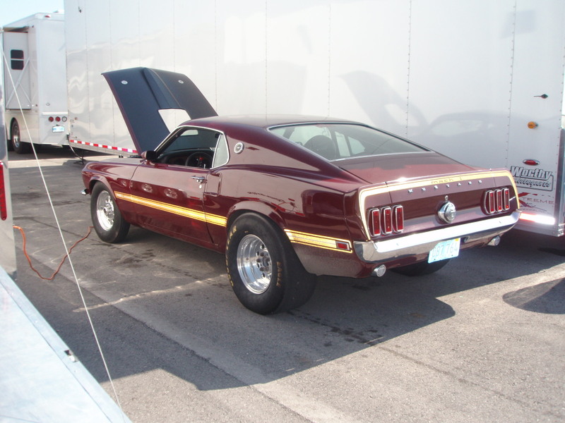

the housing moved back around an inch or so. I had a friend who tried to install big street tires on a 1969 mustang, and gained quite a bit if room by moving the housing back a little. Tires were centered in the wheelwell MUCH better after moving the housing back.
looks to me that the car had the rear centered in the wheel opening. There was no way a 30 would have fit the 70 Mustang I was racing. That car had the totally stock rear suspension.
Nope it's in the stock location. Now I'm not sure if the quarter panal was cut or anything but I don't think it was. It is a tight fit and was rubbing in a few place but made the adjustment and they fit good now.
I guarantee that something has been done to that 69`s 1/4 panels to make those slicks fit. A 30" tall slick would be hitting the factory wheel openings badly just sitting still, let alone with high speed tire growth. I`ve had slicks on several of my 69 & 70 Mustangs, 28 1/2" was the tallest I felt comfortable with.

Even if it fits when sitting still, a bias ply slick will grow at speed. If it's a radial it shouldn't grow.
A 28.5 tire was the tallest that would work on my 69. I tried a 29 which fit while the car was parked but it rubbed the front of the wheel opening when the tire grew.
Like N20 Mike said the rearend could be moved back a bit.
I agree that a 28" slick is about as tall as a stock 69-70 Mustang will hold comfortably, as Jay mentioned, the front of the wheel opening is the closest point. A 9x28" M/T slick shoulfd fit fine, although they actually measure a bit less than 27 1/2" tall. Frankly, with 3.70 gears, I`d be tempted to try the 26" tall M/T`s, I make plenty of 11 second passes on the 8 1/2" x26-15 M/T`s I used to run on my 69 Mach 1. If you think they are too small, they also make a 10x26" slick.
