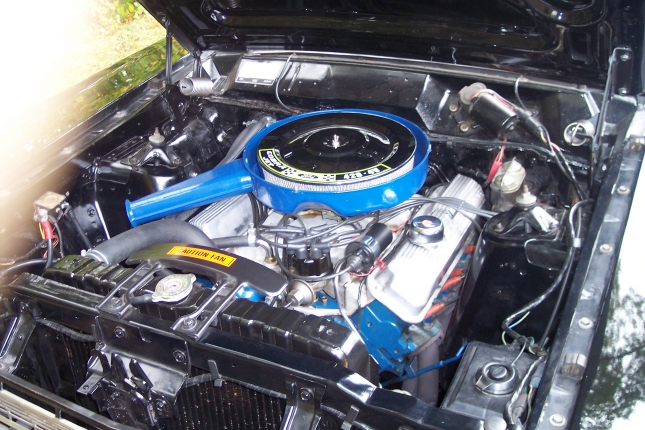

(Login UTRY)
I Didn't have to drill one hole....
October 21 2008, 4:02 AM
It was an automatic so the only thing I had to cut was the shift linkage ear off the column to clear the clutch rod/Z bar. 69 Fairlaine 9" rear and all the BB brackets bolted right in. 69 428 CJ hooker super comp 6113, 4 speed toploader. Left the engine pretty much at CJ specs. Heavy duty Torino wagon front springs and the sway bar required using the short oil filter. Plan on installing sub frame connectors. It Goes like the wind.
This message has been edited by UTRY on Oct 21, 2008 11:10 AM
Bob

Wow. Beautiful car. Looks like you had to cut the hood though (LOL). n/m
October 21 2008, 5:28 AM
n/m
(Login Falcon67)
Verrry nice
October 21 2008, 7:04 AM
Shaker and all - good job.

(Login lestuff)
I think i just became a Falcon fan
October 21 2008, 11:32 AM
Very very nice. Well done sir. you have done a very clean, nice, all around build. You should be proud of that. Mebbe i gotta git me one 'o them...
