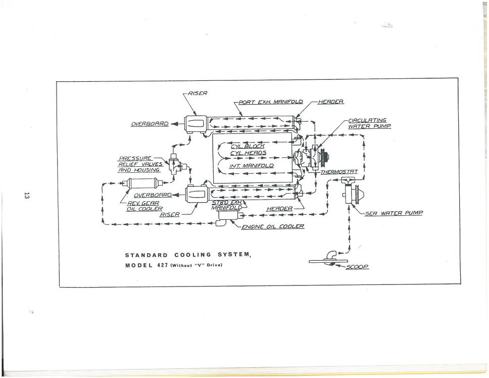

You must find the cause of "no water flow" to the motor.
June 5 2006, 10:20 PM
Hello Bill,
Running an impeller dry won't do it any good, they'll get real hot and they'll wear too. A proper impeller and pump will prime the pump with a slight amount of suction. It's not too much of a lift because the motor is so low in the boat, but there is a slight vacuum to do this. A malfunctioning pump won't create the suction, I suppose you could put some water in through the top to help with initial lubrication of the pump to create that initial prime, but something is keeping the pump from priming itself and this needs to be fixed because it will just act up again later. An improper impeller won't create any suction either, side clearances are VERY important.. They are not supposed to be run dry, and they are not supposed to be hot.
If the impeller is working, and the seacock is open and the hull strainer and strainer container are free flowing, you WILL get water into the motor.
I'm wondering if the seacock is fully open to allow flow to the pump? Has there been ANY water circulating? Surely there has been some water, or the rubber exhaust pipes would be totally cooked. I suppose you could use a garden hose to check flow, but don’t put city water pressure into the motor, because it’s not designed for that. You could flow water gently to the circulating pump, and you could also blow water down through the intake strainer, to double check flow there by backflushing.
I didn't see an answer from you about the type of cooling on this motor, so I am assuming you have the standard (raw water) cooling and NOT the heat exchanger system. Here is the standard diagram.
Note the water all goes through the reverse gear oil cooler first, where it is split into various routes back into the motor. This entire flow could be checked with a garden hose if you took the time to do so, by hooking the hose to the motor side of the reverse gear cooler. However, since your sea water pump was dry, it seems it's the problem.
It would be easy to disconnect the hose leading to the reverse gear oil cooler, to establish water flow from the sea water pump. It would also be easy to unhook the two long copper pipes that run parallel to the valve covers on their way to the riser, to check for flow there too. A couple lengths of clear tubing might be interesting too, just for testing to observe water flow (that water will be hot, and clear tubing won't last much longer than a test run or two). Each side should have the same degree of flow out of the motor.
Having a motor stall out because it got too hot isn’t a good thing. If you have good oil in the motor, chances are you have not done any serious damage as long at the motor didn’t seize up.
The carb won’t function properly if things are too hot, so this may be part or all of the issue, but one thing is certain, and that’s the fact that you MUST find out why you are not getting water though the motor. Once you get water flowing, and verified by short runs, disconnected water hoses diverted safely to the bilge, etc., then you can go after any remaining running problems. Sounds to me you have the wrong impeller??????
Good luck, keep us posted!
Regards, Paul

Hmmmm, sea water pump running the proper rotation?
June 5 2006, 10:24 PM
Wonder if the sea water pump isn't the proper rotation, getting hot, and never going to pump water? Your earlier post indicated the motor would run fine at the dock, but upon running at speed it would overheat. Obviously water was circulating at one point.
Just start verifying flow starting at the pump, or some close logical other location, and work your way back.

(Login Commander1)
Questions and Comments
June 5 2006, 10:29 PM
Hi Bill, sounds like you have your hands full! I will focus on the idea that your problem could be cooling water related.
You said it is fresh water cooled. I want to make sure we understand what you mean by that. There are basically two ways of cooling a boat engine. The first is the water you are floating in (lets call that "sea water" for now) actually circulates right through the engine block. The other is the boat engine has a closed cooling system like a car does, but instead of a radiator a boat uses a water-to-water heat exchanger to get rid of engine heat. The engine coolant flows through one side of that heat exchanger, and "sea water" flows through the other side. That second system is sometimes referred to as "fresh water cooled". Fresh water cooled boats have two water pumps -- one on the engine (like a car) that circulates the engine coolant through the closed system, and one to pump the "sea water" through the other side of the system.
Assuming that your problem is cooling related, and knowing that you have replaced the thermostat and pump impeller (I'm assuming that is the impeller on the "sea water" pump), it is possible you have a blockage in your cooling system somewhere. You mentioned that the pump was bone dry (again assuming your are talking about the "sea water" pump). That makes me think you have a blockage on the sea water side. Make sure your thru-hull seawater valve is open (obvious, but never hurts to ask). If that is open, you will want to check the flow in your sea water side to make sure it is free. Old pump impeller rubber parts can get stuck in places that will block the flow -- next time you have your sea water pump open, take a dental pick or something similar and probe both the intake and discharge sides for any rubber parts.
Something we did to find our overheating problems was to take the tubing apart where the "sea water" goes into the engine exhaust risers (we checked to make sure that tubing was above the waterline so we wouldn't flood the boat), and then fired the engine and timed how long it took to fill a 5 gallon bucket. Did the same on both engines, and found the seawater system on one engine was only putting out about 1/2 the volume as the other side. We backflushed the seawater system, took the heads off the heat exchanger, and did other things until we found our problem, which was old impeller rubber crumbs in the intake elbow of the pump (how did they get into the intake side of the pump instead of the discharge side -- who knows?).
On the 427s there is also a spring loaded "relief" popit valve where the seawater goes into the exhaust risers -- that can get crudded up and taking it apart and cleaning it up will be helpful.
One thing you NEED to do is spend $40 on a Digital Non-Contact Temperature Gun (you just aim it at what you want to read the temp of and pull the trigger - and the temperature will be displayed). If you have a temperature problem, that tool is critical for finding it. Constantly check the temps off all parts of both engines, and if something is overheating you will find it with that.
I don't remember you saying what boat you have -- maybe I misse it. Let us know just out of curiosity.
Good luck, Curt...
