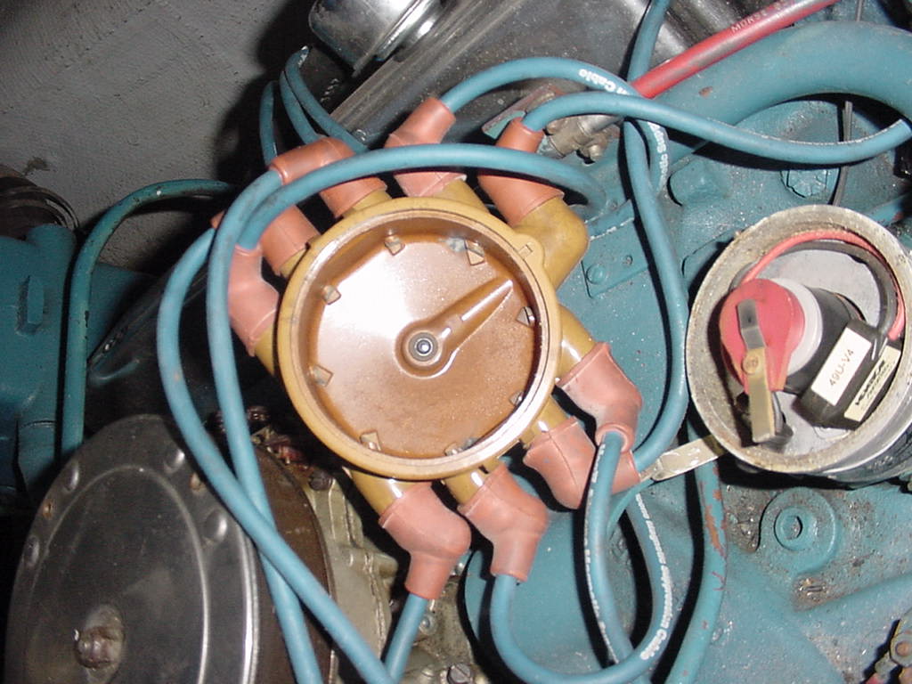

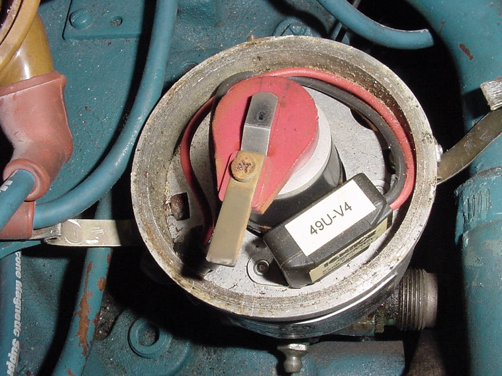

      Here’s the unit installed in place of the ole points and condenser. The original rotor is re-used, but there is a trip wheel inserted below to trigger the ignition pulse.
      After several years of running the Pertronix system, I have some carbon tracking on the underside of the crab cap, but otherwise great reliability and performance.

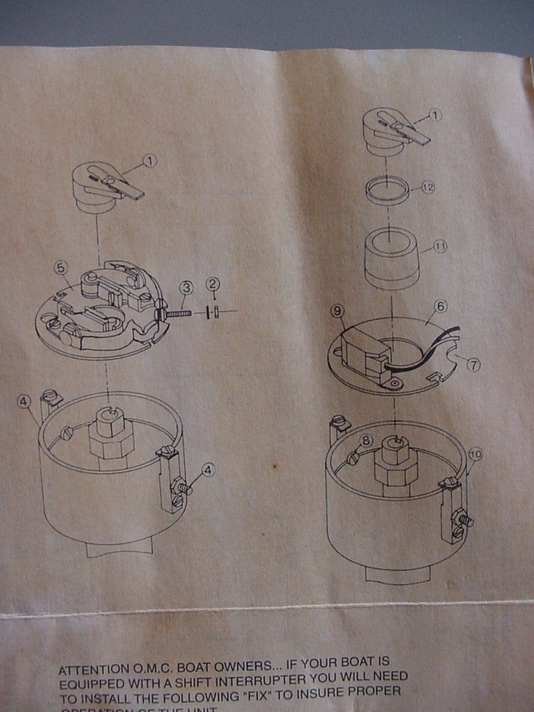

      Here’s the schematic: original points assy on the left, pertronix on the right. Sorry for the crappy photo, I don’t have a scanner here at the ranch.

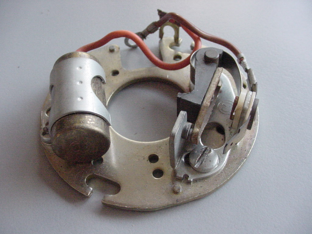

      Here’s what comes out, you just pull the armature and points/condenser out, and save it as a momento.
