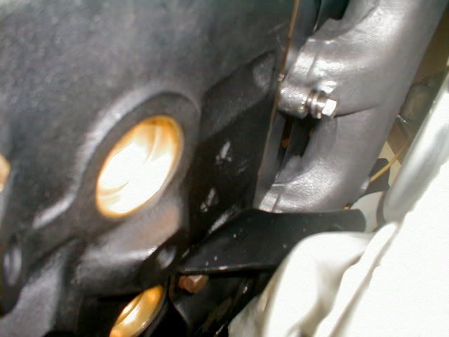

Has anyone here found an advantage on opening up the lower middle water jacket on a new set of head gaskets for a 1959-60 430cid? Here are some pics of what I'm talking about....
430 Block & new head gasket:
[IMG][/IMG]
Head side veiw of same blocked off water jacket:
[IMG][/IMG]

Are you sure you have the correct gasket? Is it a FEL-PRO?

Yes I have all Fel-Pro brand gaskets.....

This gasket is from BEST GASKETS-
There is no hole on their's either it appears.
FEL-PRO seems to have dropped the ball on MEL as there were so many engine variations over the model years.
If the hole was in the origional, I would consider opening it.
