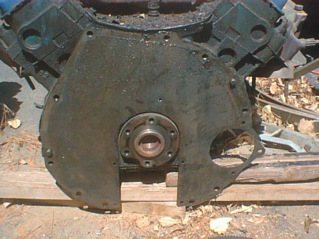

1966 462 block with 390/428 block plate on it. All holes line up except for the bottom right where Ford redesigned the block for a lower starter mounting location. Unless you cut the corner of the block off there is no way to put an early bellhousing on this due to the ear of the block sticking in where the starter would normally go:

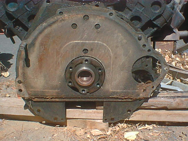

Back of 462 block with stock plate on it:
Back of 462 block with stock plate on it and 390/428 plate overlapped:

I needed that 462 shot desperately!
