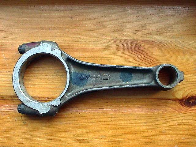

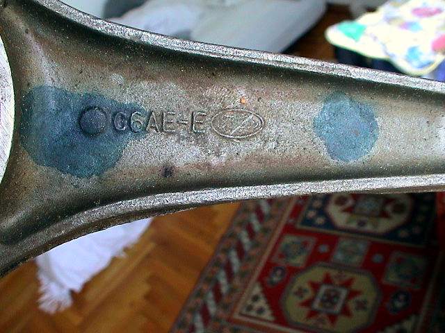

The blue colour on your rocker tips remind me at the blue spots that were on my NOS FE Le Mans rods. Maybe it's some kind of rust protection to amke the product longer storable.

The green paint identifies the parts as to how and when assembled to more easily trace warranty problems. There is also a red and blue sizing for many engine parts to ensure a more correct assembly.
